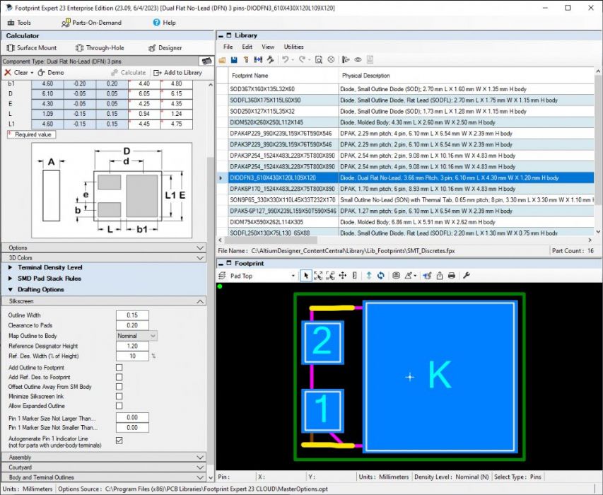

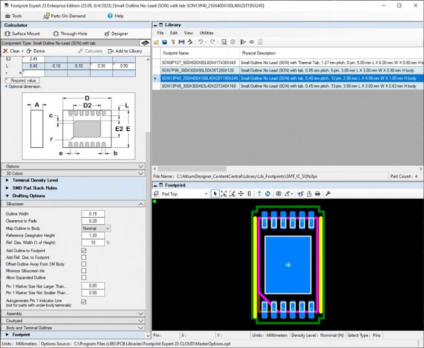

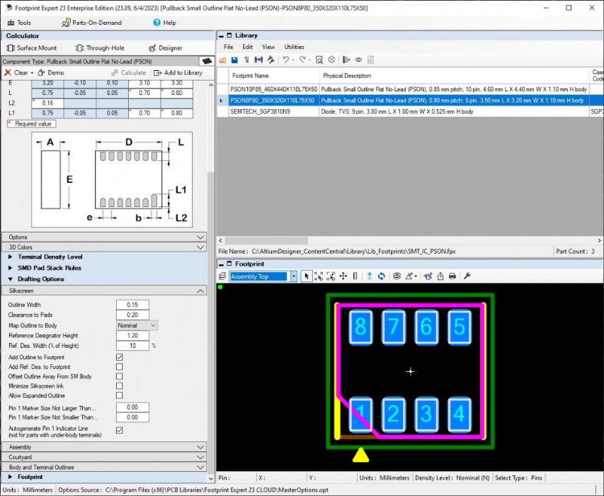

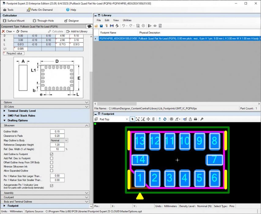

I noticed that the silkscreen outline doesn't always follow the body outline regarding to my Drafting options. This is especially true form Bottom Lead Components, but may also be seen on SON (and others?).
Look at the DFN example below, this is quite obvious.
As stated in the following screen captures, my default drafting option is to draw a 0.15mm Silkscreen line (yellow) to match the Nominal body outline (brown), with a 0.2mm clearance to pads. What seems to happen for DFN, PQFN, SON and PSON is that the Silkscreen outline is expanded to avoid violating the pad-clearance rule, whereas both options "Allow Expanded Outline" and "Offset Outline Away from SM Body" are disabled.
Is this a feature? Shouldn't it be ruled by the "Allow Expanded Outline" setting?
DFN:
PQFN:
SON:
PSON:

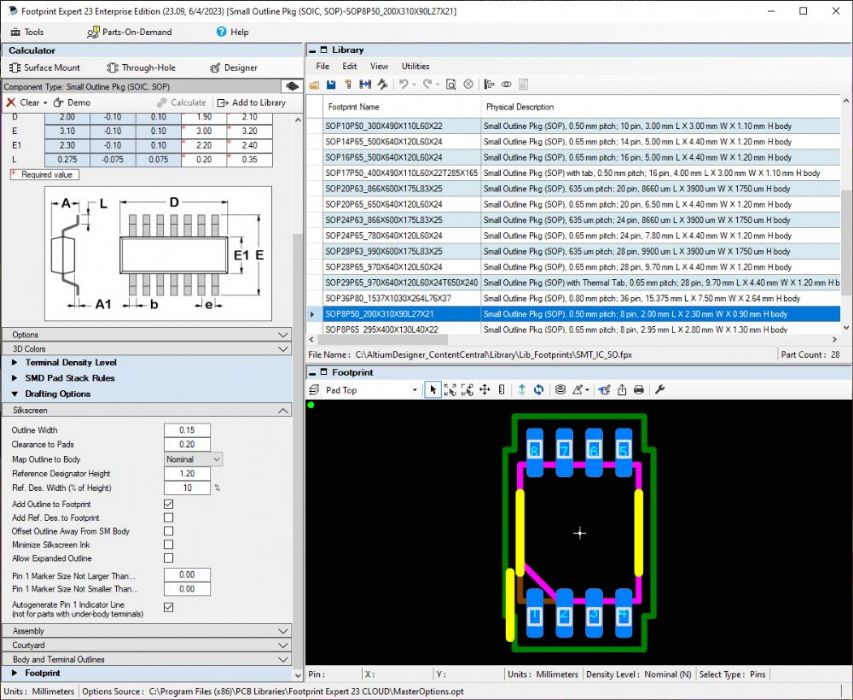

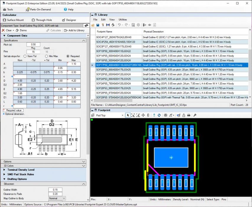

Notice that things are handled correctly for the Small Outline family (SOIC and SOP), even for very tiny packages.
SOP8P50:
SOP17P50:

This was fixed in V23.09 pre-release available here - www.pcblibraries.com/downloads

Look at my captures: they are taken from 23.09 dated 6/4/2023.
Please note that this is a different concern than the previous one we talked about regarding the Designer.

The rules for "Allow Expanded (Silkscreen) Outline" and "Offset away from Body" only apply to the relationship between the outline and the body when that spacing is greater than the spacing to a pad. In all of these cases (expanded, offset, or clearance-to-pad) the outline will not represent an accurate geometry.  This is apparent in your DFN, PQFN and SON examples.  Maybe you're expecting the silkscreen to contour to the body where it can?  That can be done in most cases in calculated parts where the finished outline is predictable, but in some (like parts where the pads may be either totally or partially under the body) the variations are too numerous, and it must be simplified to simple lines or rectangles.
Outlines are handled differently in FP Designer parts where there is an algorithm that actually can contour the silkscreen. This is required since the outline for any given FPD part may encounter any number of "obstacles" that might interfere with the outline.
To allow us to answer specific questions in the future would you please include a reference part, either with dimensions, a data sheet, an fpx file or the 'Demo' part, so we can reproduce an example of your issue and follow along with your inquiry.

Here is an FPX file containing the 4 footprints with "inconsistent" silkscreen outlines:
And here is an extract from the SO family, which, to me, is the example to follow even for bottom lead components:

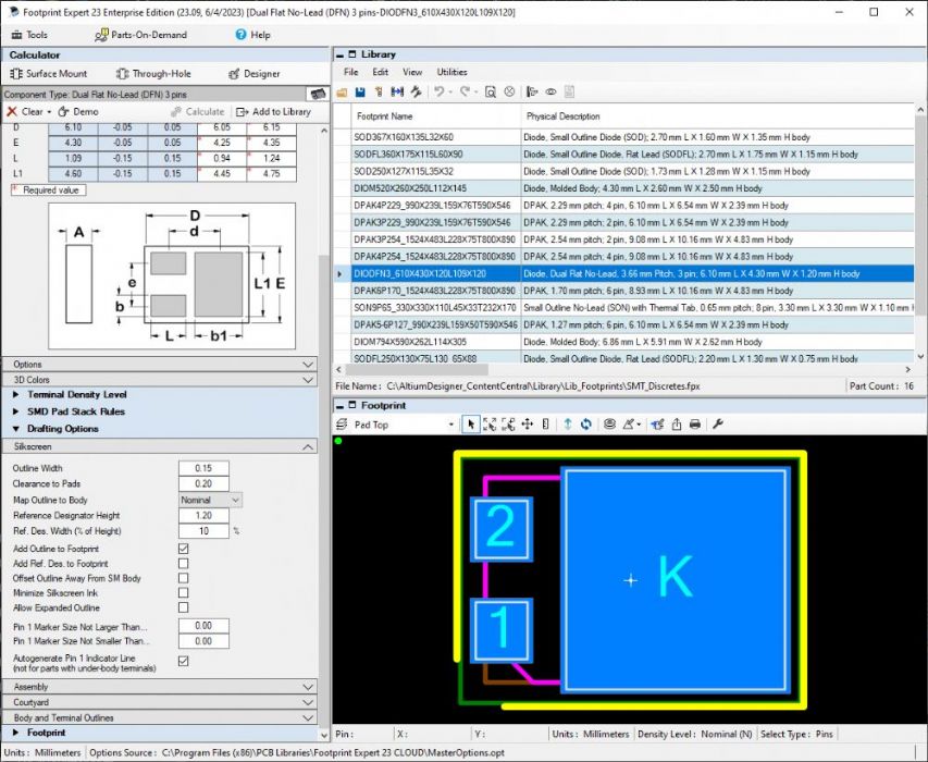

Bridging the gap with my original examples, below is what I would have expected to get in order to be consistent with the rest of my footprints:
DFN:
Instead of:
SON:
Instead of:
Is this something already possible with the latest version of the software?

There are no plans to change any silkscreen outline options except to fix errors that might result in manufacturing or fabrication defects.
