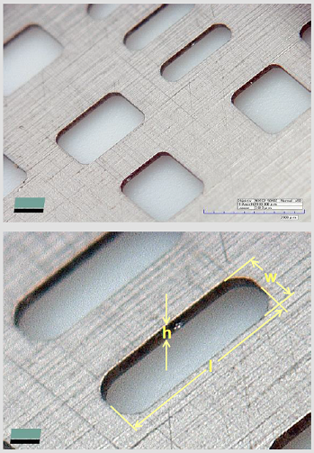

Rounded Rectangle pad shape conforms to the paste mask stencil aperture opening.
The stencil maker uses a laser to cut the aperture openings and rounds the corners of rectangular shapes to increase the stencil release yield.
Typical Stencil -
