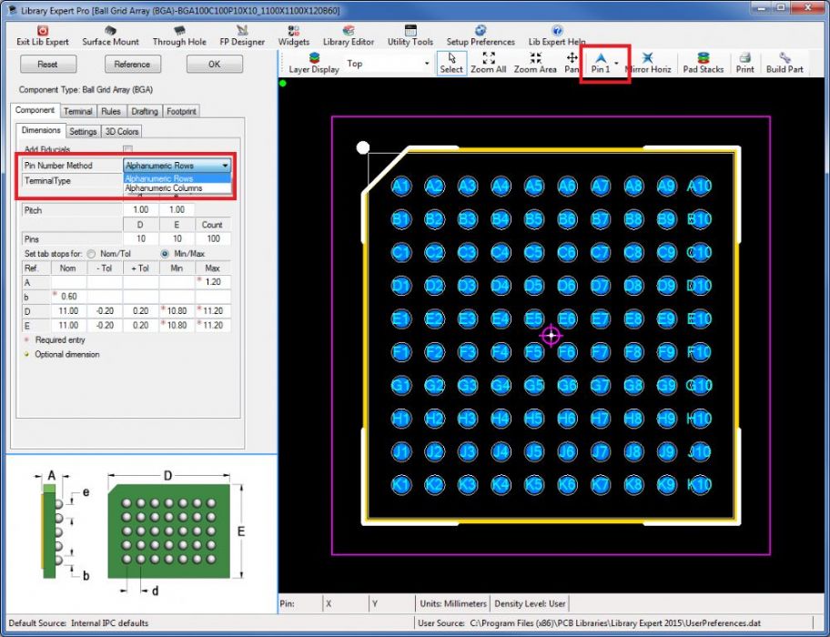

I have the following bga that needs pin 1 on the top left and the pins renamed A1 a2 a3 on the top row. How can I accomplish this ?

The problem is I have a 6 pin bga that I want to renumber the alphanumeric pins. How do you do this. If I select he properties I cannot change the pin name. Also I need to move the pin 1 silkscreen from the bottom left to the  top left after I renumber  the pins. How do you do this also ?
Thanks!

Thanks Tom. That was too easy.
