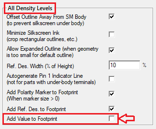

Is there any setting to stop the Val** text on F.Fab layer to be created in KiCad output footprints?
In older version of KiCad I believe that Val** was mandatory, but this is not true any longer.

Go to 'Tools > Options > Drafting > Silkscreen > All Density Levels > Add Value to Footprint > Uncheck it'
