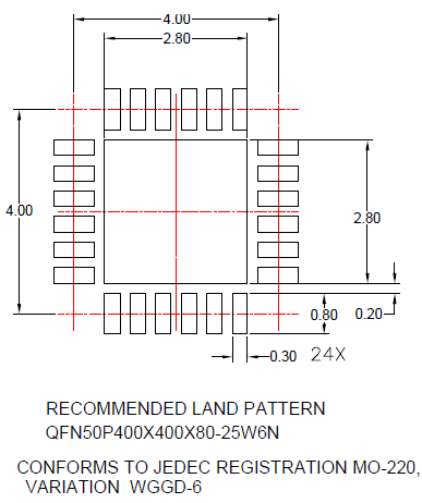

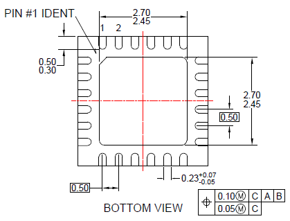

Here is a component manufacturer that produces QFN packages with D-shape Package Leads -
Here is their recommended footprint with Rectangular footprint pads. Also notice that the Component Thermal Tab has a Chamfer Corner by Pin 1 and rounded corners on the others, but the manufacturer recommends a solid square with no chamfer or rounded corners. So it's really a "User Option".
Also note that the manufacturer is calling the footprint a "Land Pattern" and they are using the IPC-7351 Land Pattern Naming Convention with the JEDEC variation in the Land Pattern Name (W6) to discriminate the Thermal Pad size.
