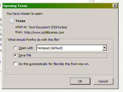

Hi, I am using Firefox as well, but without any download managers.  My version is 29.0.1.
The last time I downloaded from the POD before today I downloaded okay without any problems, the downloaded file had the extension .fpx
Today after reading this thread I tried again.  I only see one button for download. Unlike Erwin, when I download I see an extension but it's .txt not .fpx but using delete and entering .fpx in the dialogue box worked okay with a downloaded file now having a .fpx extension.
I've never previously had any issues so I suspect it's a recent update on my system that's caused this.

Tried Chrome and .fpx downloads okay.
Problem seems to only be on Firefox updates from a week or so ago.  I have only a few add ons installed in Firefox - AdBlock Plus, Do Not Track Me, HTTPS Everywhere, NoScript, Password Exporter, and Logitech SetPoint.  I disabled all of them but still have the same problem as Erwin.
I suspect it's a webserver/firefox issue with MIME.
I have an issue at the moment with Firefox and an external CSS file on a site I manage for my hash chapter where Firefox on Windows XP won't show the CSS on the HTML page. I found that it's got something to do with the MIME configuration on the webserver but I have no access to change that even if I knew how. Just wondering if it's a similar problem here.

I did a little reading and discovered a piece where Mozilla say they decided to handle MIME in a different way to make it more flexible for users.
I'm not bothered about a fix, it's pretty quick to change the file extension myself.
Most manufacturers provide their 3D models or PCB footprints in a zip archive I've noticed, probably just because of this or similar issues.
