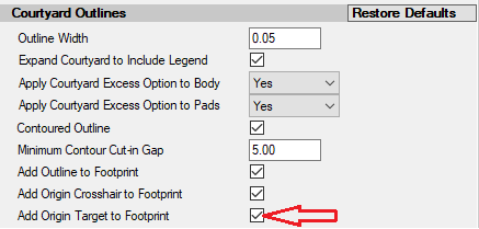

When I create a new cell and I bring it into Expedition Library Manager I noticed there are two Placement outlines.
One is normal that is around the part and one is a circle in the center of the part.
Is there a an option which would turn off the Placement Outline which is a circle in the center of the part?
Kirby
Post Options Post Options   Thanks (1) Thanks(1)   Quote Tom H Quote  Post ReplyReply Direct Link To This Post Posted: 18 Aug 2021 at 11:05am
Turn off (uncheck the box) to the Centroid origin circle:
"Tools > Options > Drafting > Courtyard Outlines > Add Origin Target to Footprint
