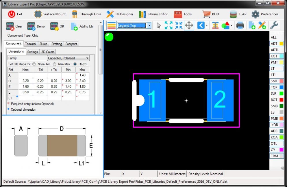

It seems there are Pin 1 dot issues on 2 pin polarized parts.  The pin 1 dot is on the pad.  I’ve noticed it with the following families:
 CHIP – Polarized
MELF
Molded Body
SODFL
 Is there a preference setting causing this?  I don’t see any control over the position in the preferences besides Legend Outline Placement Roundoff.  But I don’t want to change that value as it changes all the Silk lines as well as the pin 1 dot.  It is currently set to 0.01 which is the default I believe.
This problem is present in version 2016.10 and 2016.11  Can this be corrected with a setting change or is it a bug?  See image below of a demo polarized chip cap.

This issue has been fixed in the latest V2016.11 pre-release - www.pcblibraries.com/downloads
Let us know if you have any further issues and thank you for reporting this issue.
