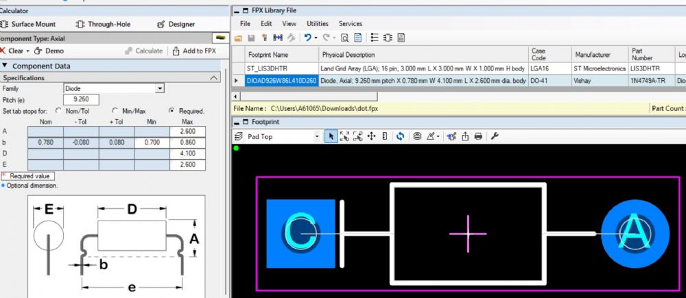

i noticed there are some products which pin 1 dot indicator doesn't appear in assembly layer, however i aleady choose this options, can please add more details
Points: 5926
Post Options Post Options   Thanks (0) Thanks(0)   Quote Tom H Quote  Post ReplyReply Direct Link To This Post Posted: 3 hours 43 minutes ago at 2:34pm
The Assembly 'Polarity Dot' only appears in 'Polarized' components.
i.e.: there is no Polarity Dots on Resistors or Non-Polarized Capacitors or Inductors.
Points: 177
Post Options Post Options   Thanks (0) Thanks(0)   Quote m.elsayed Quote  Post ReplyReply Direct Link To This Post Posted: 2 hours 58 minutes ago at 3:19pm
this happen with for 2 cases, zener and other part in attache fpx
Points: 489
Post Options Post Options   Thanks (0) Thanks(0)   Quote Jeff.M Quote  Post ReplyReply Direct Link To This Post Posted: 2 hours 47 minutes ago at 3:30pm
TH Axial parts display a line (as shown) instead of a dot by pin1, plus an optional square pin.
Points: 177
Post Options Post Options   Thanks (0) Thanks(0)   Quote m.elsayed Quote  Post ReplyReply Direct Link To This Post Posted: 2 hours 43 minutes ago at 3:34pm
what about ST part? i send attach in mail have other 3 parts please check
Points: 5926
Post Options Post Options   Thanks (0) Thanks(0)   Quote Tom H Quote  Post ReplyReply Direct Link To This Post Posted: 2 hours 29 minutes ago at 3:48pm
We're adding a Chamfer or Dot to polarized Axial Lead footprints in the next release.
