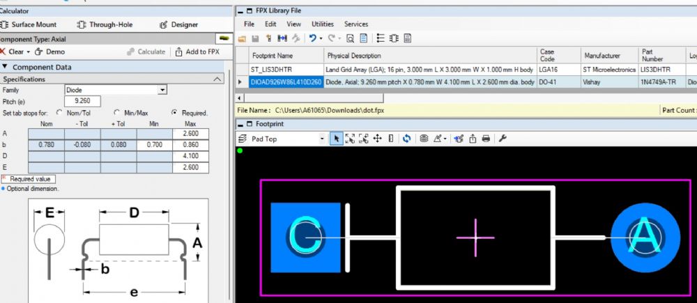

I noticed there are some footprints which pin 1 dot indicator doesn't appear in assembly layer, however I already choose this option, can please add more details.

The Assembly 'Polarity Dot' only appears in 'Polarized' components.
i.e.: there is no Polarity Dots on Resistors or Non-Polarized Capacitors or Inductors.

this happen with for 2 cases, zener and other part in attache fpx

TH Axial parts display a line (as shown) instead of a dot by pin1, plus an optional square pin.

what about ST part? i send attach in mail have other 3 parts please check

We're adding a Chamfer or Dot to polarized Axial Lead footprints in the next release.
