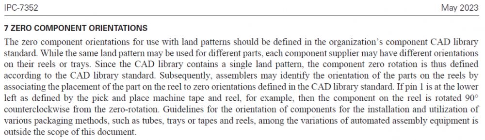

Posted: 22 May 2026 at 8:59am |
Here's the IPC-7352 correction on Zero Component Orientation.
