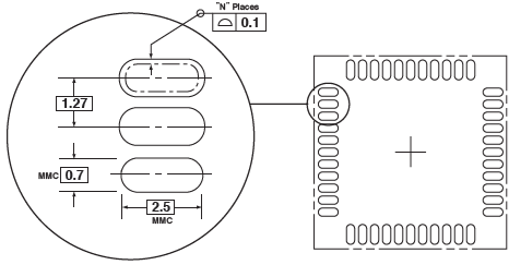

The Oblong style was the next most popular pad shape due to the release of the IPC-7351 "Generic Requirements for Surface Mount Design and Land Pattern Standard" in 2005 for Surface Mount technology.
Image from IPC-7351:

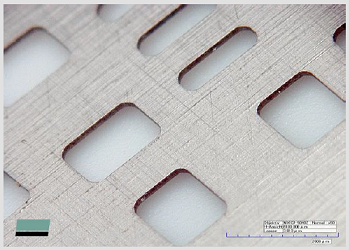

However, in 2001 CAD vendors started to add Rounded Rectangle pad shape as an option. It was a marketing concept, and they claimed that rounded rectangle pad shape was best for lead-free solder, but they never explained why. The rounded rectangle pad shape was a trade off between rectangle and oblong. The reason to move away from rectangle pad shape was because the paste mask stencil used lasers to cut aperture openings and the aperture corners were rounded. Also, assembly shops had issues with rectangular apertures and new lead-free solder alloys sticking in the corners during the stencil release. To solve this problem, they experimented with rounded corner apertures and had better stencil release results.
Laser Cut Paste Mask Stencil:
Even if the PCB library uses rectangle pad shapes, the paste mask stencil apertures still have rounded corners. Thus, no paste mask in the pad corners. The left image is lead solder. Right is lead-free solder.
It didn’t take long before the rounded rectangle pad shape became popular. The paste mask stencil manufacturer could use the rounded rectangle pad shape to achieve full paste mask coverage on the pad and achieve the best paste mask stencil release.

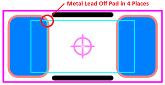

The biggest question is how much corner radius is good and does making it too big cause problems. The best solution is to establish a corner radius percentage of the pad width and have a corner radius limit. The smaller the pad width and smaller the corner radius. The most important issue is that the component package terminal lead must reside 100% on the pad. The ideal situation is not to have a metal terminal lead corner hanging off the rounded cornered pad in an area that has no solder mask.
Another advantage of rounded rectangle pad shape is RF PCB layout. RF designs perform better by avoiding square corner copper features for pads, traces and copper pour.
Many terminal leads are rectangular shaped, so the corner rounding should be modest.
