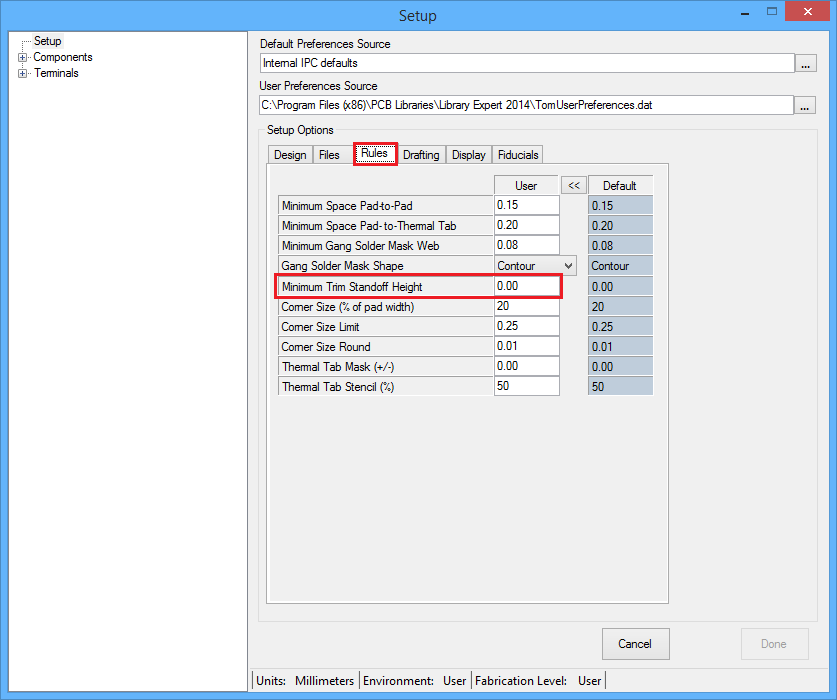

Post Options Post Options   Thanks (1) Thanks(1)   Quote Tom H Quote  Post ReplyReply Direct Link To This Post Posted: 24 Mar 2014 at 11:53am
IPC Standards does not like the software default to be set to "Trim Pads Under Low stand-off Component", but the feature is still in the program and you have control of the "Stand-off Size" too.
Go to "User Preferences" and select the "Rules" tab and enter any standoff value you want to start pad trimming under component body at -

Post Options Post Options   Thanks (1) Thanks(1)   Quote Guido Quote  Post ReplyReply Direct Link To This Post Posted: 25 Mar 2014 at 3:56am
Hello Tom,
this option is exact what I was looking for. Thank you very much.
As I use the Library Expert Lite I can't change the User preferences. But this is no major problem. I can change this setting every time when I built a new footprint.

Post Options Post Options   Thanks (0) Thanks(0)   Quote Tom H Quote  Post ReplyReply Direct Link To This Post Posted: 26 Mar 2014 at 6:59am
With the "Lite" version you have to setup all your personal preference rules for each library part.
With the "Pro" version you set everything up once and use it over and over.

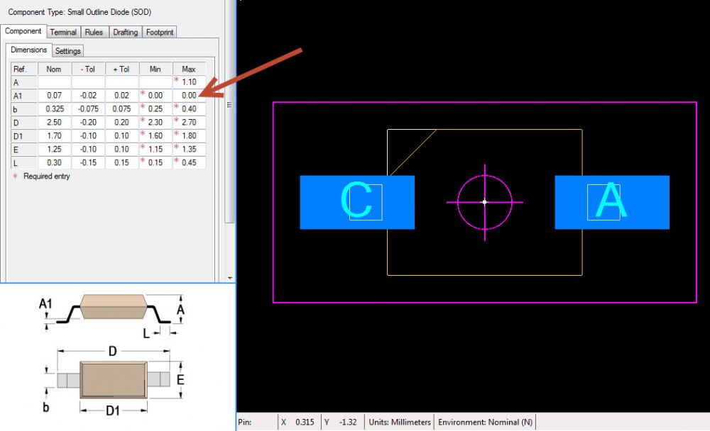

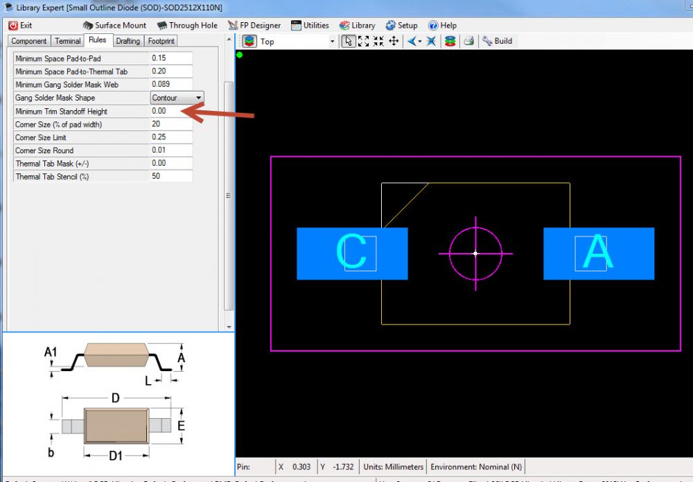

Post Options Post Options   Thanks (1) Thanks(1)   Quote RandyB Quote  Post ReplyReply Direct Link To This Post Posted: 09 Apr 2014 at 8:26am
The trim does not seem to be working SODs, either that or I do not have the rule set correctly.  See attached .jpgs
Randy
Points: 497
Post Options Post Options   Thanks (0) Thanks(0)   Quote Jeff.M Quote  Post ReplyReply Direct Link To This Post Posted: 09 Apr 2014 at 12:09pm
Trim is applied when the the Rule is set to a value greater than zero and the component standoff height (A1) dimension is less than the value entered for the rule.
That said, this is still a bug in the SOD footprint.
