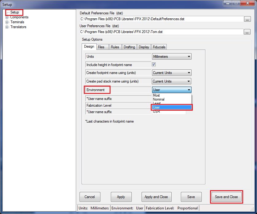

Any time you change any "USER Preferences" you must set the Environment Level to "User" in "Setup > User Preferences" -

Post Options Post Options   Thanks (0) Thanks(0)   Quote Tom H Quote  Post ReplyReply Direct Link To This Post Posted: 29 Dec 2012 at 11:41am
If you want to create a single library Environment then "User Preferences" is the best option.
If you want to create a "3-Tier" Environment library system with different Zero Orientations then you must create a personal "Default Preference .dat" file using the Default Preference Editor and load the new .dat file in "Setup > User Preferences > Default Preferences".
