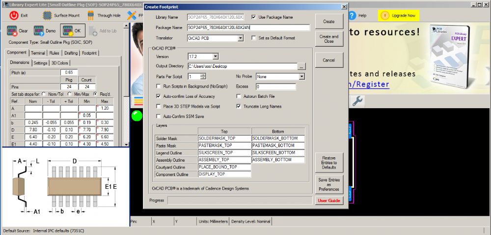

What does your layer mapping look like?

Post Options Post Options   Thanks (1) Thanks(1)   Quote DSchaef Quote  Post ReplyReply Direct Link To This Post Posted: 26 Jan 2017 at 6:28am
It's the default mapping:
