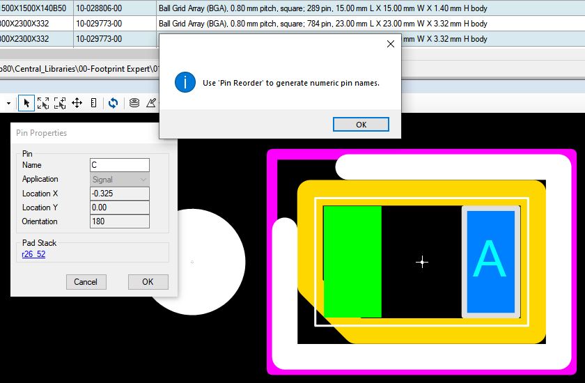

Post Options Post Options   Thanks (0) Thanks(0)   Quote slabrecque Quote  Post ReplyReply Direct Link To This Post Posted: 21 Mar 2023 at 5:39am
Sorry, I don't get it to work the way you described it.
If I try change Alpha pin to Numeric in Pin Properties, I got this message (Use 'Pin Reorder' to generate numeric pin names), but can't find it anywhere. (See image below)
Also for exemple, with your method, I can change a 'C' for a 'K', but this information is not saved to the FPX file.
I don't understand why I have some diodes in my FPX with alpha pin and others with numeric pin.
I'm lost...
Thank you!
Sylvain

Post Options Post Options   Thanks (0) Thanks(0)   Quote Tom H Quote  Post ReplyReply Direct Link To This Post Posted: 21 Mar 2023 at 11:33am
We'll replace "Reorder Pins" with "Pin Properties" in the DFN component family in V23.06.
Post Options Post Options   Thanks (0) Thanks(0)   Quote Tom H Quote  Post ReplyReply Direct Link To This Post Posted: 22 Mar 2023 at 2:18pm
You should download and install the latest V23.06 pre-release - www.pcblibraries.com/downloads
