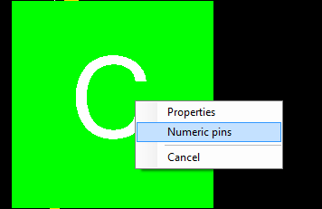

You need to "Right Mouse Click" on the pads.
If the Pad has an Alphabetical name this will appear -

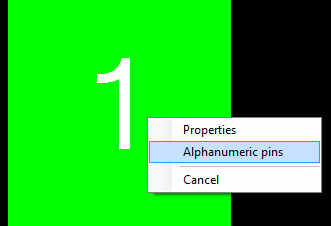

If the pad has Numeric pin assignment, this will appear -
