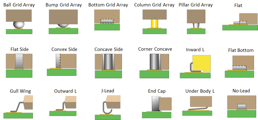

Every component in the world is broken up into a "Lead Style" and the PCB Library Expert (LE) supports all component lead styles.
Here are the Lead Forms that LE supports -
Just open any component family with the appropriate Lead Form and type in the "L" dimension and the other dimensions can be fake. You are only interested in the pad size calculation for your rules or IPC-7351 3-Tier.
