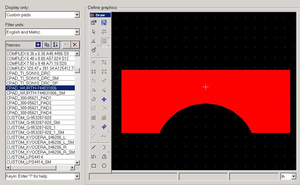

For odd shape or irregular shape pad our naming convention is CPAD_CELL NAME. The picture show an example to this. CPAD means it is custom defined pads. The padstack is used for a WURTH inductor. If we want the Solder mask or paste different than the pad we choose to add a suffix _SM or _SP to the padstack name.
Nightwish

I use a similar naming fashion, just the mfr&series for example JOHNSON_142-0711201-L where the L means left if required. The "CPAD" may be redundant because the pad is already in the "custom pads" partition.
