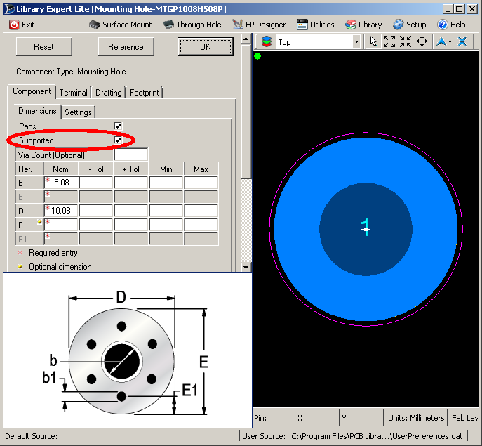

What is the difference between mounting holes which are created with checked/unchecked "Supported" option?
Is there any documentation about this feature? I use the Library Expert Lite 2013.20.

These are IPC-7351 terms:
Supported = Plated
Unsupported = Non-plated

If the programmer does not repute important to change the word "Supported" to "Plated"
He can add a tooltip that appear when the mouse go on the Check box icon that display the sentence:
"Supported means Plated, unchecked means Non-Plated"

OK, after further discussion with the programmers, we are changing the GUI text "Supported" to "Plated" in the next release V2014.12 coming out this weekend.
Thanks for the feedback and suggestions.
