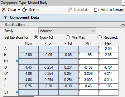

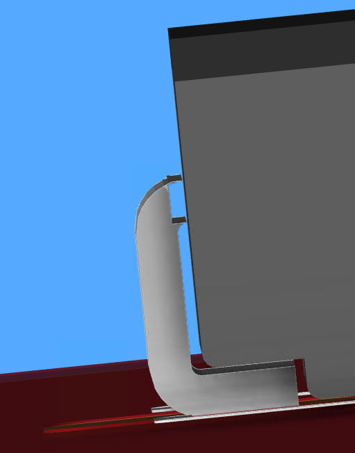

When I look at a STEP file for a molded body exported from Footprint Expert, I'm seeing issues with both pins on the part.
It looks like the top part of the pins can't properly solidify.
I'm seeing this anomaly in OrCAD and E-Drawings.
If I export a STEP file with just this one part on the board in OrCAD, it fails when trying to import into CREO (MCAD software).

The master 3D STEP model was designed for the JEDEC DO-214 package.
Major Note: The "D" dimension must be at least (minimum) 0.80 mm larger than the "D1" dimension.
This allows the 0.20 mm thick terminal lead to exit the package and have a bend radius.
There are some Molded Body packages where the terminal lead is against the package body. This is a non-standard package and it's not recognized by JEDEC, EIA or IPC.
You need to use the FP Designer module to create these non-standard footprints using the mfr. recommended pattern. And get the 3D STEP model from the component mfr.

Understood. Request you consider this as a possible enhancement for the future. I know the manufacturer's don't always follow the standards, but it's what we have to deal with (and they don't always have a STEP file and then we would have to generate one manually).  Also, would it be possible to provide some indication that the 0.8mm requirement was being violated? That way I would know there's an issue right away. I do a quick visual check, but don't normally zoom in to check all the geometry of the STEP file. I only found this since my MCAD team was complaining about it.
