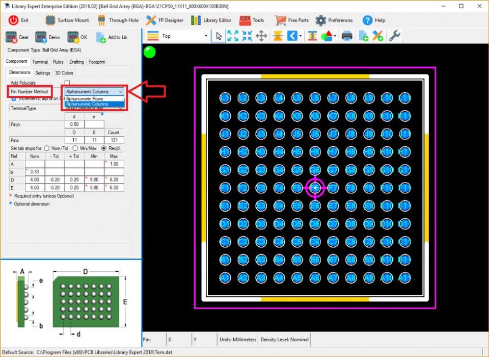

Post Options Post Options   Thanks (0) Thanks(0)   Quote Tom H Quote  Post ReplyReply Direct Link To This Post Posted: 09 Feb 2018 at 6:34pm
I can relate to your situation, but the Mirror feature is exclusively for seeing the "Bottom Side" for the sole purpose of matching the datasheet to depopulate pins.
You must un-mirror the BGA prior to putting into your FPX file.
The feature that you need is Alphanumeric Rows or Columns -
