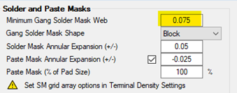

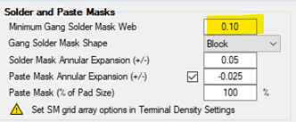

Hi, I’d like to understand how work Minimum Gang Solder Mask Web in SMD Pad Stack Rules

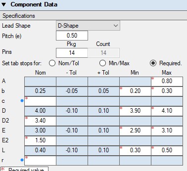

I have these specifications in Component Data
If I use 0.10 mm for the Minimum Gang Solder web mask, I get a 0.83 x 0.40 mm mask, so the web mask = 0.10 mm that is correct
If I use 0.10 mm for the Minimum Gang Solder web mask, I get a 0.83 x 0.50 mm mask, hence the web mask. I don't understand why the mask becomes 0.40 mm to 0.50 mm.
I expected the mask to stay at 0.40 mm for a 0.10 mm web

Are you wondering why the solder mask excess isn’t limited to prevent a sliver instead of increased to fill the sliver?

Yes, that’s what I would like to know!
Points: 5915
Post Options Post Options   Thanks (0) Thanks(0)   Quote Tom H Quote  Post ReplyReply Direct Link To This Post Posted: 20 Dec 2023 at 9:57am
First, setting the solder mask web to 0.10 is overkill.
Fabrication shops can easily produce a 0.07 solder mask sliver.
Where the Fabrication industry needs is a 0.05 mm solder mask swell and a 0.05 solder mask web.
This will ensure a solder mask sliver between every SMD pad stack and eliminate Gang Masking of entire rows of pads.
Ask your fabrication shop how accurate is their solder mask application process.
