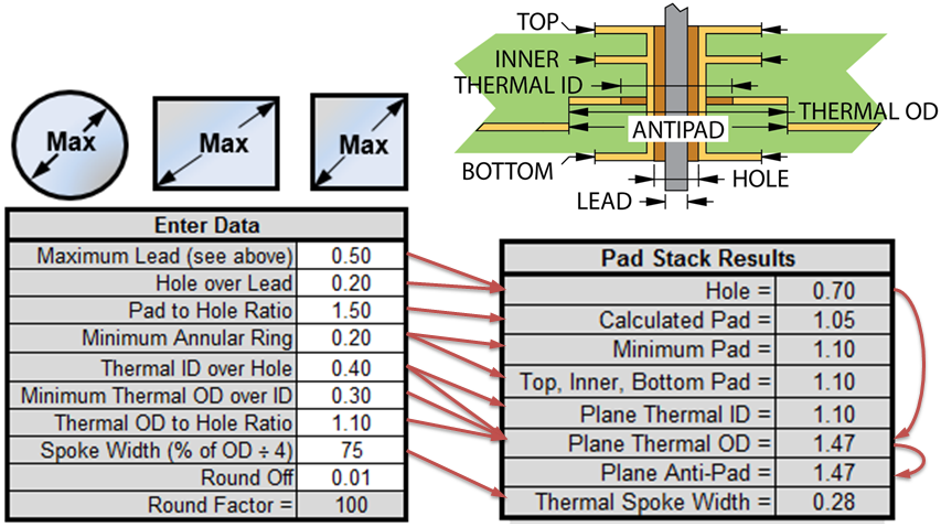

As far as the changes to the Proportional Pad Stack math goes, we have finally found a good algorithm that works, but the "Minimum Annular Ring" feature overrides the hole to pad size multiplier. The current Multiplier = Hole X 1.50 mm but you can change the 1.50 multiplier to whatever you want. C4hange it to 1.6 or 1.75 and see the difference.
Here is the latest PTH Reference Calculator - PCB_Library_Expert_PTH_Reference_Calculator.zip
Here is how the PTH Reference Calculator and Library Expert PTH calculations are made.
