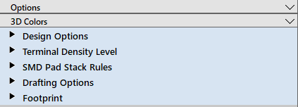

Here are the Local Options in every standard package Calculator:

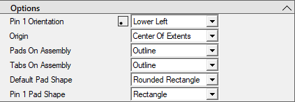

Options
  • Set the Pin 1 Orientation. Changes to this setting are saved to the FPX file library.
    • Lower Left - default setting
    • Lower Right
    • Upper Right
    • Upper Left
  • Origin - This is set locally and not saved to the FPX file library.
    • Center Of Extents - default setting
    • Pin 1
  • Pads On Assembly - This is set locally and not saved to the FPX file library.
    • None - default setting
    • Outline
    • Filled
  • Tabs On Assembly - This is set locally and not saved to the FPX file library.
    • Outline
    • Filled
  • Default Pad Shape - This is set locally and not saved to the FPX file library.
    • D-Shape
    • Oblong
    • Rectangle
    • Rounded Rectangle - default setting
  • Pin 1 Pad Shape - This is set locally and not saved to the FPX file library.
    • D-Shape
    • Oblong
    • Rectangle

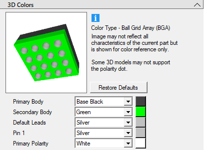

3D Colors - Any changes are saved to the FPX file library.
  • Set the Primary Body
  • Secondary Body
  • Default Leads
  • Pin 1
  • Primary Polarity

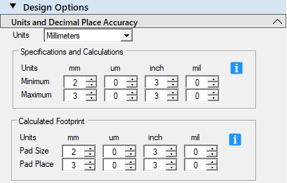

Units and Decimal Place Accuracy - These settings are not saved to FPX file library
  • Units - units are not saved to the FPX library
    • Millimeters - default setting
    • Micrometers
    • Mils
    • Inches
  • Specifications and Calculations
    • Minimum settings appear in the Calculators
      • 1 = 0.1
      • 2 = 0.01- default setting
      • 3 = 0.001
      • 4 = 0.0001
      • 5 = 0.00001
      • 6 = 0.000001
    • Maximum setting is the character limit in the Calculators
      • A setting of 3 will limit the calculator input values to 3 places to the right of the decimal point
  • Calculated Footprint
    • Pad Size roundoff
      • 1 = 0.1
      • 3 = 0.001
      • 4 = 0.0001
      • 5 = 0.00001
      • 6 = 0.000001
    • Pad Place roundoff
      • 1 = 0.1
      • 3 = 0.001
      • 4 = 0.0001
      • 5 = 0.00001
      • 6 = 0.000001

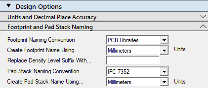

Footprint and Pad Stack Naming - These settings are not saved to FPX file library
  • Footprint Naming Convention
    • PCB Libraries (formally IPC-7351C and approved by the IPC Land Pattern Committee)
    • IPC-7351B
    • IPC-7352
  • Create Footprint Name Using (Units)
    • Micrometers
    • Mils
    • Inches
  • Replace Density Level Suffix With… - users can create their own Density Level
  • Pad Stack Naming Convention
    • IPC-7352 - default setting
    • IPC-7351B
  • Create Pad Stack Name Using (Units)
    • Micrometers
    • Mils
    • Inches

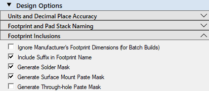

Footprint Inclusions
  • Ignore Manufacturer's Footprint Dimensions (for Batch Builds) - Default Off
  • Include Suffix in Footprint Name - Default On
  • Generate Solder Mask - Default On
  • Generate Surface Mount Paste Mask - Default On
  • Generate Through-hole Paste Mask - Default Off (Pin-in-Paste Technology

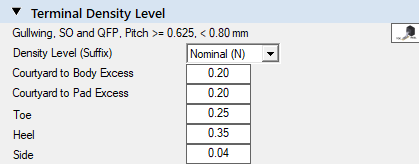

Terminal Density Level - These settings are not saved to FPX file library
  • Density Level (Suffix)
    • Least (L)
    • Nominal (N) - Default Setting
    • Most (M)
  • Courtyard to Body Excess
    • 0.20 - Default Setting
  • Courtyard to Pad Excess
  • Toe
  • Heel
  • Side

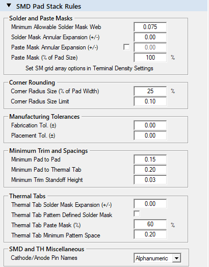

SMD Pad Stack Rules - These settings are not saved to FPX file library
  • Solder and Paste Masks - None of these settings are saved to FPX file library
    • Minimum Allowable Solder mask Web - 0.075 (default)
    • Solder Mask Annular Expansion (+/-) - 0.00 (default)
    • Paste Mask Annular Expansion (+/-) - unchecked default setting
    • Paste Mask (% of Pad Size) - 100% (default)
    • Set SM Grid Array Options in Terminal Density Settings
  • Corner Rounding
    • Corner Radius Size (% of Pad Width) - 25% (default)
    • Corner Radius Size Limit - 0.10 (default)
  • Manufacturing Tolerances
    • Fabrication Tol. (+/-) - 0.00 (default setting per IPC-7352)
    • Placement Tol. (+/-) - 0.00 (default setting per IPC-7352)
  • Minimum Trim and Spacing
    • Minimum Pad to Pad - 0.15 (default)
    • Minimum Pad to Thermal - 0.20 (default)
    • Minimum Trim Standoff Height - 0.03 (default)
      • This is used on Gullwing Terminal Leads to trim pads under packages with the PCB standoff of less than 0.03
  • Thermal Tabs
    • Thermal Tab Solder Mask Expansion (+/-) - 0.00 (default)
    • Thermal Tab Pattern Defined Solder Mask - Off (default)
    • Thermal Tab Paste Mask (%) - 60% (default)
    • Thermal Tab Minimum Pattern Space - 0.20 (default)
  • SMD and TH Miscellaneous
    • Cathode/Anode Pin Names
      • Alphanumeric (default)
      • Numeric

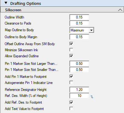

Drafting Options > Silkscreen - These settings are not saved to FPX file library
  • Outline Width 0.15 (default)
  • Clearance to Pads - 0.15 (default)
  • Map Outline to Body
    • None
    • Minimum
    • Nominal
    • Maximum (default)
    • Margin
  • Outline to Body Margin - 0.15 (default)
    • This is used when Map Outline to Body Margin is selected
  • Offset Outline Away From SM Body - On (default)
    • This converts the line origin from the center to the edge of the line
  • Minimize Silkscreen Ink - Off (default)
    • This converts Full Silkscreen Outline to Hatched Outline
  • Allow Expanded Outline - On (default)
    • This wraps the silkscreen outline around the footprint if the silkscreen outline clearance to pads rule is violated
  • Pin 1 Marker Size Not Larger Than - 0.50 (default)
    • The polarity dot diameter is determined by the pad width. This setting limits the diameter.
  • Pin 1 Marker Size Not Smaller Than - 0.50 (default)
    • The minimum polarity dot size for visual inspection without magnification is 0.40
  • Add Pin 1 Marker to Footprint - On (default)
  • Autogenerate Pin 1 Indicator Line - Off (default)
    • This feature only works for pads outside the component body and not BTC components
  • Reference Designator Height - 1.20 (default)
  • Ref. Des. Width (% of Height) - 10% (default)
  • Add Ref. Des. to Footprint - On (default)
  • Add Text Value to Footprint - Off (default)

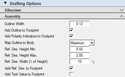

Drafting Options > Assembly - These settings are not saved to FPX file library
  • Outline Width - 0.12 (default)
  • Add Outline to Footprint - On (default)
  • Add Polarity Indication to Footprint - On (default)
    • This adds a 45-degree chamfer in the assembly outline near pin 1
    • Minimum
    • Nominal
    • Maximum (default)
  • Ref. Des. Height Min. - 0.50 (default)
    • The Ref Des is scaled to fit inside the assembly outline
  • Ref. Des. Height Max. - 2.00 (default)
    • This is the maximum assembly ref des height

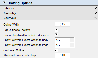

Drafting Options > Courtyard - These settings are not saved to FPX file library
  • Outline Width - 0.05 (default)
  • Expand Courtyard to Include Silkscreen - On (default)
  • Apply Courtyard Excess Option to Body - Yes (default)
    • Selecting No will turn off the courtyard excess
  • Apply Courtyard Excess Option to Pads - Yes (default)
    • Selecting Ignore will turn off the pads
  • Contoured Outline - On (default)
    • Off = a rectangular courtyard
  • Minimum Courtyard Cut-in Gap - 5.00 (default)
    • This feature controls the courtyard cut-in between the pads

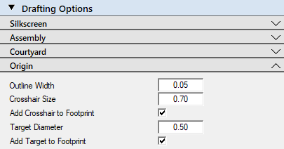

Drafting Options > Origin - These settings are not saved to FPX file library
  • Crosshair Size - 0.70 (default)
  • Add Crosshair to Footprint - On (default)
  • Target Diameter - 0.50 (default)
  • Add Target to Footprint - On (default)

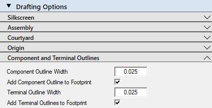

Drafting Options > Component and Terminal Outlines - These settings are not saved to FPX file library
  • Component Outline Width - 0.025 (default)
  • Add Component Outline to Footprint - On (default)
  • Terminal Outline Width - 0.025 (default)
  • Add Terminal Outlines to Footprint - On (default)

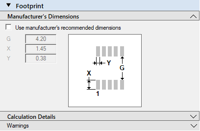

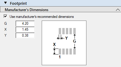

Footprint > Manufacturer's Dimensions - These dimensions are saved to the FPX file library
  • Use manufacturer's recommended dimensions - Off (default)
    • Selecting On turns on the manufacturer's dimension cells
      • G = pad to pad gap
      • X = pad length
      • Y = pad width

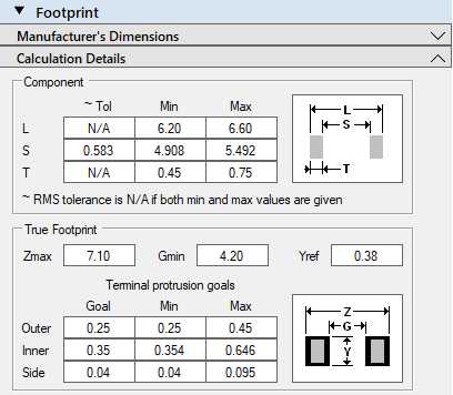

Footprint > Calculation Details - These settings are not saved to FPX file library

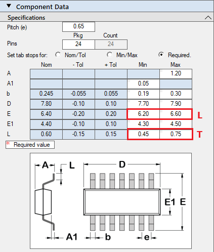

  • Component
    • These are package dimensions
      • L = E
      • S = G
      • T = L
  • True Footprint
    • Zmax = G + X times 2
    • Gmin = G
    • Yref = Y
  • Terminal Protrusion Goals
    • Outer - Goal, Min, Max
    • Inner - Goal, Min, Max
    • Side - Goal, Min, Max
