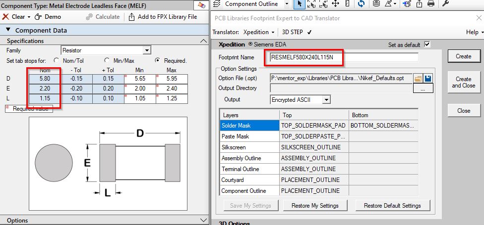

HI,
I am creating a landpattern for a melf resistor.  According to the landpattern naming conventions the pattern name for a melf resistor is ;
RESMELF + Body Length + Diameter + L Lead Width
Looking at the generated name for the landpattern, it uses the nominal dimensions for the body lenght and the lead width and the maximum dimension for the diameter.
I also would expect the nominal diameter there.
Regards, Charles
