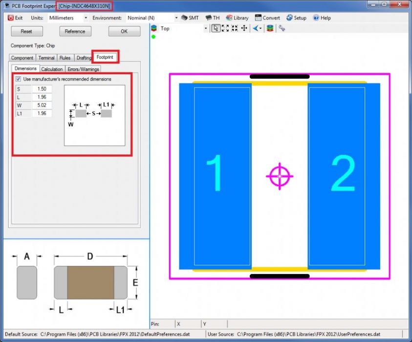

Dear FPX developers,
I will be using a Taiyo Yuden SMT power inductor on my board. The closest I could get from FPX v2012.18 is the "DFN 2 Pin" package family generator.
The catalog of these Taiyo Yuden inductors are found here:
http://www.yuden.co.jp/productdata/catalog/en/wound04_e.pdf
Is the DFN 2 Pin the best generator for these parts?
Do you think this needs another generator?
What term should I actually use for these "package family generators"?
Best regards,
Maarten Verhage
Points: 5991
Post Options Post Options   Thanks (0) Thanks(0)   Quote Tom H Quote  Post ReplyReply Direct Link To This Post Posted: 17 Sep 2012 at 7:54am
I would use the "CHIP" component family "Inductors" and then I would select the "Footprint" tab and enter the Taiyo Yuden SMT power inductor recommended pattern dimensions.
