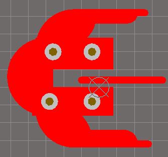

footprints like for this type of connectors:

Using the "Footprint Designer", you can create almost any PCB library part in the industry as long as you either have the through-hole lead size or the SMT pad size.
The Footprint Designer allows you to place PTH and SMD pads on any grid with any pin name.

You can make this footprint but you would probably want to do it without the silkscreen or courtyard.

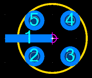

Can a footprint like this be done in the PCB Library Expert FP Designer?

This part is a unique one-of-a-kind footprint and would probably be built in the native CAD tool and then translated to every CAD tool and made available in the native CAD format.
This is about as non-standard as you can get.
