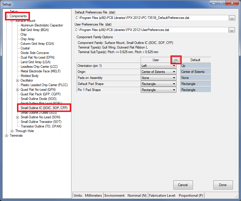

The "IPC-7351B_DefaultPreferences.dat" produces the correct Zero Component Orientation (Pin 1 Left or Upper Left). In order to see the correct results the User Preference Environment Setting must be Least, Nominal or Most. If the "Setup > User Preference" Environment Setting is set to "User" then the "UserPreferences.dat" takes over.
So if you are using UserPreferences.dat, to fix the problem, you need to update the UserPreferences.dat file to reflect the Zero Component Rotation of the "IPC-7351B_DefaultPreferences.dat" file.
There are 2 ways to easily fix this. The best way is to open "Setup > User Preferences > Component > select a Component Family > select the << button to move the Pin 1 location from Default to User"
This is how to update SOIC/SOP/CFP Zero Component Orientation -
The other way to fix the issue is to select the User dropdown menu in each component family and set the Pin 1 location to match the Default.
