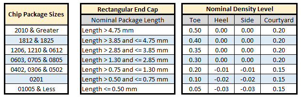

The V23.03 Footprint Expert follows the IPC J-STD-001 Standard for Solder Joint Goals. Every chip size has unique Toe, Heel and Side for all 3 Density Levels for Least, Nominal and Most.
IPC-7351C was renamed to IPC-7352 and includes guidelines and Naming Convention for through-hole packages.
The IPC-7351B was released in early 2010. The 0201 package wasn't released yet. And the IPC-7351B is not an incremental solder joint solution where every chip size has it's own solder joint goals.
Here are the V23.03 Footprint Expert Solder Joint Goals. The Toe goal is the most important. I assume that you are using something different.

The Side and Heel goals are 0.00 so the only significant value is the Toe.
The IPC J-STD-001 Standard says that the Chip Toe goal should be at least 25% of the package height or 0.50 mm, whichever is less
