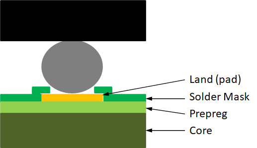

All BGA balls collapse. Non-collapsing BGA balls are created by the PCB librarian by solder mask defined pads or making the pad size larger than the Ball.
Collapsing Ball.
Non-Collapsing Ball defined by Solder Mask.

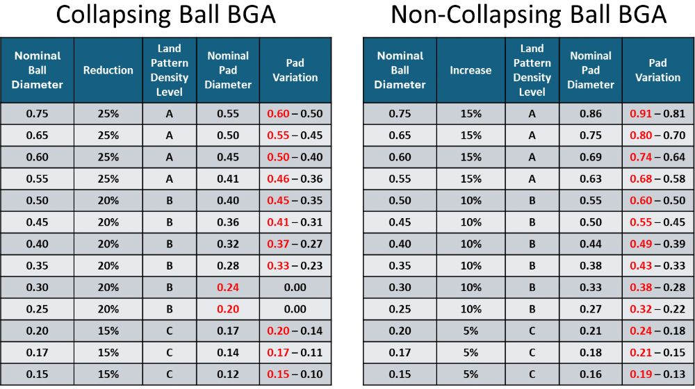

IPC-7351 BGA tables for pad size reduction for collapsing balls and pad size increase for non-collapsing balls. The pad size increase is normally used for fine pitch BGA's that require via-in-pad technology for fanout.
There are 3 Density Levels A, B and C that indicate the percentage amount for pad size calculation.

The Solder Mask Defined BGA pad helps secure the pad to the prepreg. This helps during drop tests.

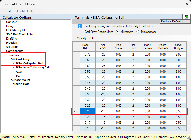

For the collapsing BGA ball with a diameter between the values listed what is appropriate reduction?
My example is a 0.242 mm diameter. Is the recommended reduction 15%, 20%, or 19.2% (linear interpolation)?

If the Ball diameter is on the dividing row between percentages the new ball size will take the lower values.
Here is a sample BGA terminal option table where the 0.24 mm Ball Diameter was added.
