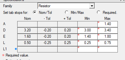

Please see attached picture.
The fields for Nominal - Tol / + Tol are grayed out regardless of the option chosen above.
Haven't used Library Expert in a while, so is this new or is this a bug?
Post Options Post Options   Thanks (0) Thanks(0)   Quote Tom H Quote  Post ReplyReply Direct Link To This Post Posted: 26 Sep 2022 at 8:12am
The "Required" dimensions are White only because if one is cell is empty the calculator won't work.
Any cell that you can put your cursor in is an editable cell.
The "Tab Stops" are used when the component mfr. only provides Nominal and Tolerance and it makes it easy for you to tab through those cells only.
