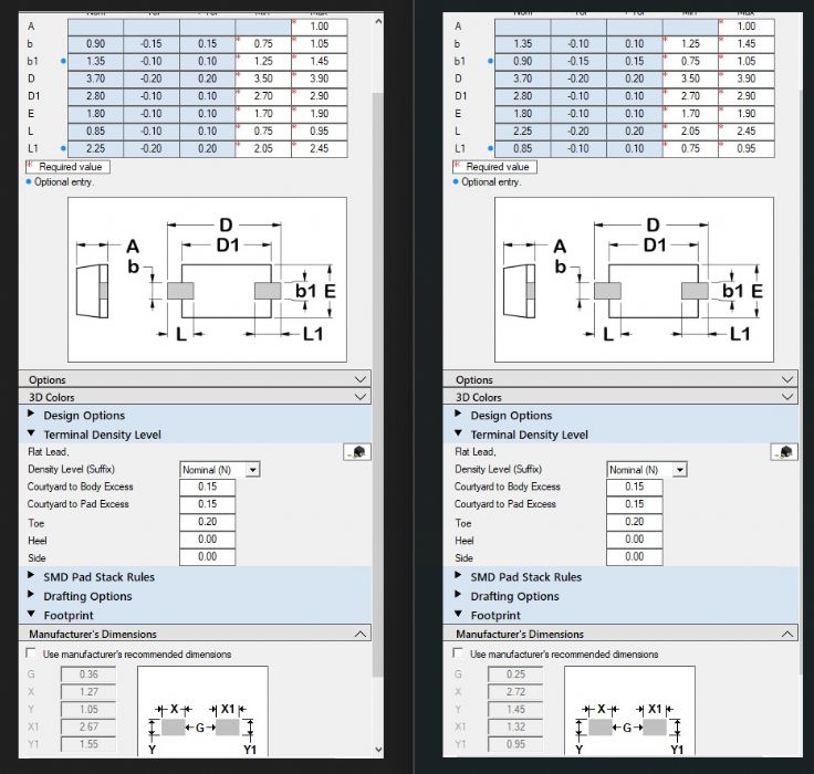

I have noticed that depending on the order in which you provide the dimensions for the SODFL package, the layout recommendation differs.
If you switch the b1 dimension with b and L1 with L, you get different padstacks. Is it a bug in the software or is there some other reason for such results?
I use the latest version of the PCB Footprint Expert.
Please see the attached screenshot for the comparison:
SODFL
Points: 499
Post Options Post Options   Thanks (0) Thanks(0)   Quote Jeff.M Quote  Post ReplyReply Direct Link To This Post Posted: 3 hours 19 minutes ago at 8:45am
This anomaly is a result in the differences between the b-b1 and L-L1 tolerances. The effect has been resolved in the latest V26.03 pre-release update, 2-20-26.
