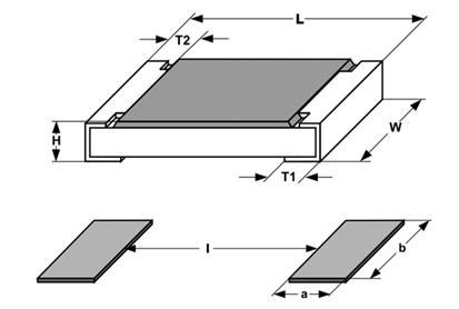

My difficulty is in obtaining information the thickness of the contacts size of the component (the size "T")
I bought the IPC-7351 and 7352. and you don't have information about this.
I think to buy EIA-JEP95 , and don't know it's worth the money if very MFG design is contacts size what "he" want's.

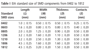

This table i found is accurate?
How you handle this with general discrete components ,when the contacts size can be between 0.10 to 0.40?
With the IPC-7351 when contacts size is 0.4 mm?

Here is the original EIA PDP-100 Chip Package dimensions and tolerances.
Compare with IEC.
