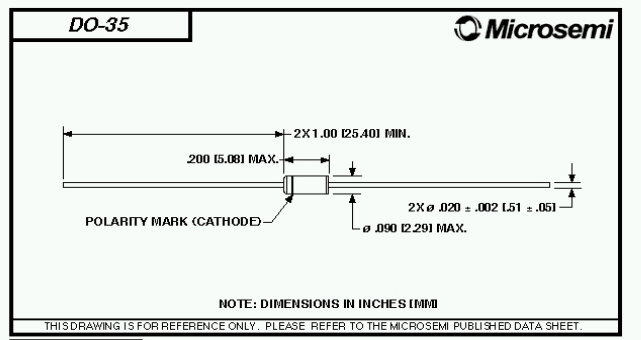

How to calculate pitch in axial component by Axial leadform calculator?
