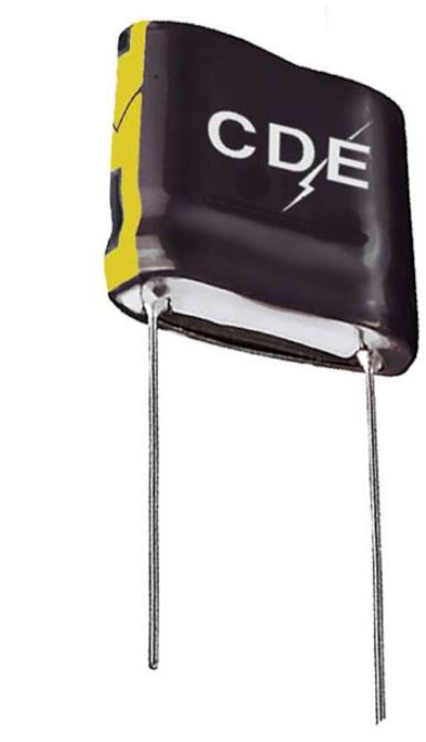

Hello;
How can I create a 3D view of shapes such as a capacitor with the code DGH355Q5R5 in Footprint Expert?

Footprint Expert goes not put text in 3D STEP models.
The component family is - Radial (Dipped) rect. - Capacitor, Polarized
You can change the color assignments for:
  • Primary Body
  • Default Leads
  • Pin 1 Lead
  • Primary Polarity
We recommend if you want the exact 3D STEP model with text, that you get it from the manufacturer.
