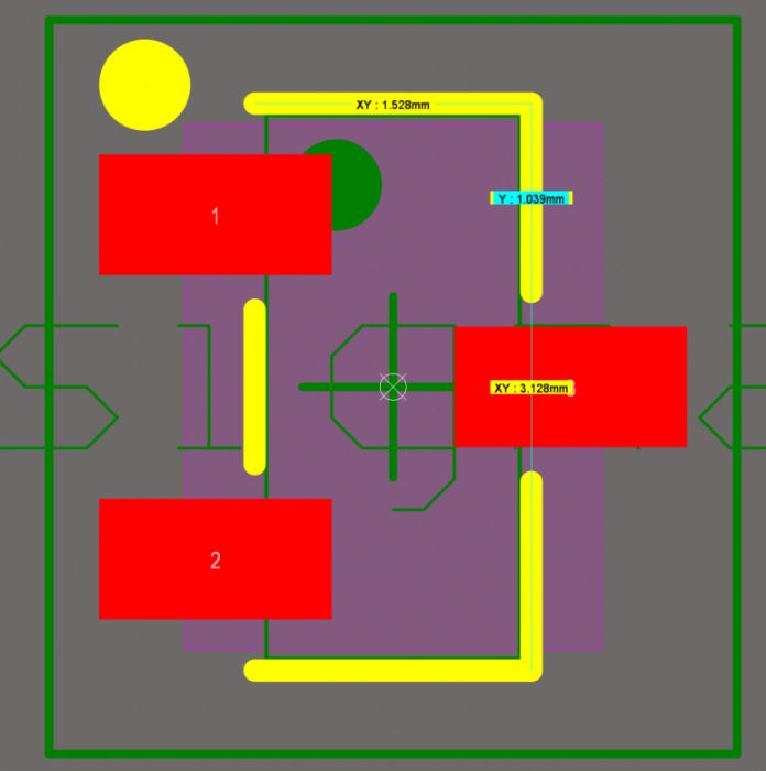

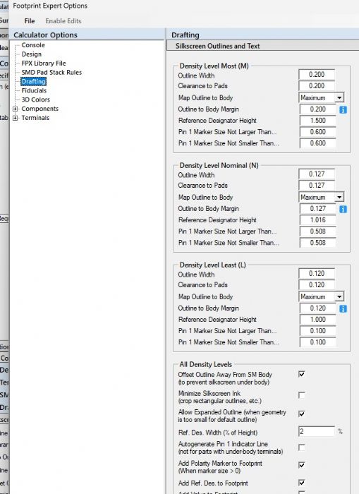

When using Footprint Expert, and align with below parameters to achieve "Outline of the component body (Length X Width) with max. dimensions with 0.127 mm line width.
However the resulting values are larger than max values like values should be 3*1.4 but appears in Altium as 3.128*1.528.
Attached FPX file -

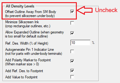

Post Options Post Options   Thanks (0) Thanks(0)   Quote Tom H Quote  Post ReplyReply Direct Link To This Post Posted: 21 Oct 2025 at 8:38am
It's because you have the 'Offset Outline Away From SM Body' selected.
Unselect this Option and remeasure.
This is only for Surface Mount Silkscreen Outlines.

Post Options Post Options   Thanks (0) Thanks(0)   Quote Tom H Quote  Post ReplyReply Direct Link To This Post Posted: 21 Oct 2025 at 9:07am
You can test is locally in the Calculator Options by checking and unchecking the Silkscreen Drafting Options?
The 'origin' of the line is the centerline when unchecked.
The 'origin' of the line is the inside line edge when checked.

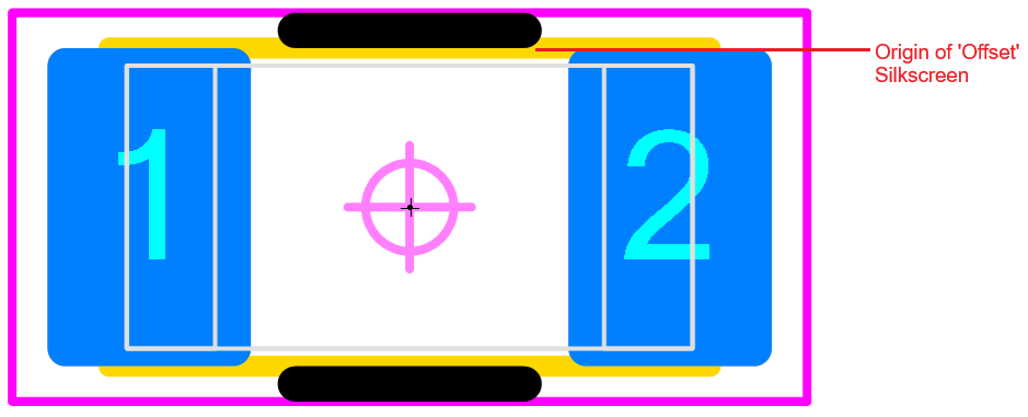

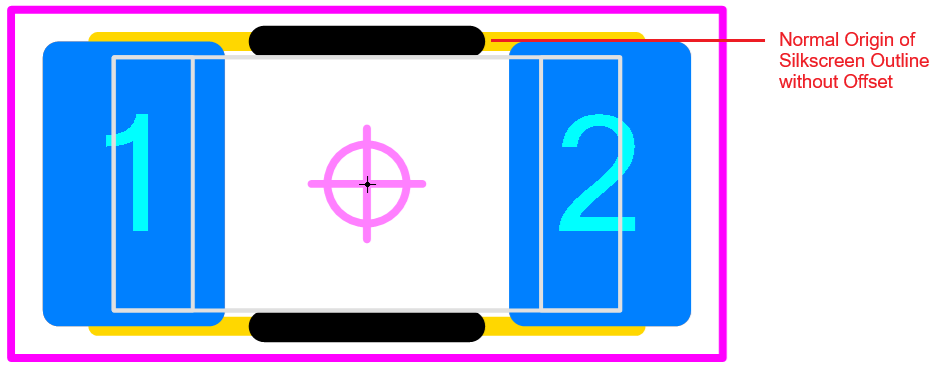

Post Options Post Options   Thanks (0) Thanks(0)   Quote Tom H Quote  Post ReplyReply Direct Link To This Post Posted: 21 Oct 2025 at 9:51am
Silkscreen Line with No Offset.
Silkscreen Line with Offset.

Points: 5941
Post Options Post Options   Thanks (0) Thanks(0)   Quote Tom H Quote  Post ReplyReply Direct Link To This Post Posted: 21 Oct 2025 at 10:20am
Silkscreen on solder mask creates a small bump.
This is why silkscreen under the package body (especially very small low profile packages) is unacceptable because it can lift the package up just enough to cause solder joint problems.
Due to the IPC J-STD-001 and the slop tolerance component package positioning that is allowed for assembly acceptability, using the no silkscreen offset can cause soldering problems if the component package moves over the silkscreen during reflow.
When you Offset the silkscreen outline, it kind of compensates for the package movement (tolerance) during reflow. Especially when you map the silkscreen to the Maximum Body Dimension.
However, some assembly shops with a higher level of component package movement during reflow, will use the Offset Margin Option to move the silkscreen further away from the package body.
It depends on the assembly shop quality and accuracy. Some shops use older equipment and require robust tolerances. While some assembly shops use new equipment with very high placement accuracy levels.
