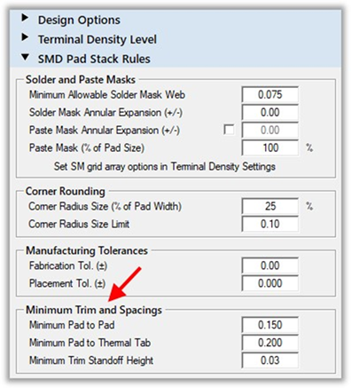

Example of a trimming rule: the Calculator trims pad sizes for you when they fail to meet the specifications in Rules.  The default values we use are all considered best industry practice.
Note: pad clearances are not guaranteed for FP Designer footprints and there are no warnings.

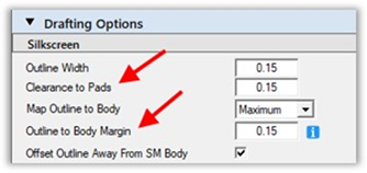

The clearance of the silkscreen to the body and any pads is set in the Drafting > Silkscreen options. The silkscreen is automatically trimmed, if required, to meet these values.

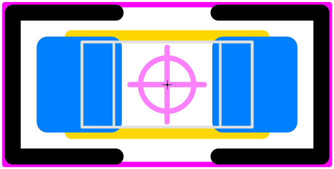

Here is a 0603 chip capacitor that has enough pad-to-pad spacing to allow a silkscreen line. This silkscreen outline length exceeds 3 line widths.

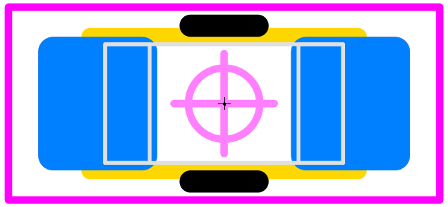

Here is a 0603 chip capacitor that violates the pad-to-pad spacing to allow a silkscreen line. The silkscreen outline wraps around the pads and the courtyard outline is pushed out to include the expanded silkscreen outline.

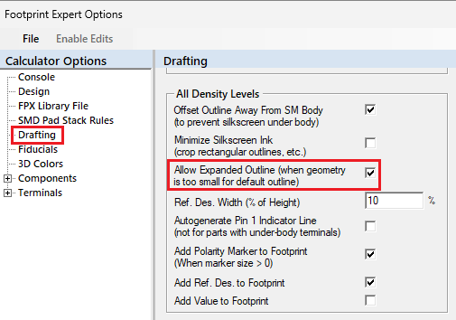

You have options to turn off the silkscreen outline if the pattern is too small to create one.

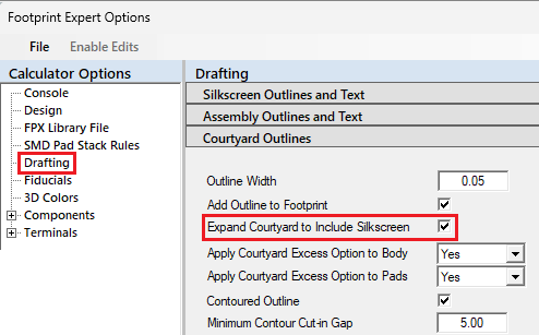

You can also turn off the courtyard excess for including the silkscreen outline.
