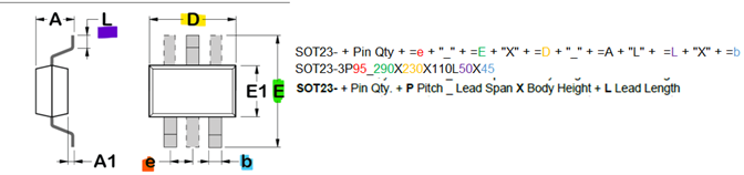

 Pcblibraries naming conventions :
For the first line of the table 1, there are three multi-source parts. This means that these three footprints must be exactly the same. Many companies use multi-source components to manage the supply chain without issues during the assembly process.
Manufacturer
Footprint pcblibraries
Nexperia
SOT23-3P95_290X230X110L30X43 ?? (NEXPERIA_TO-236AB)
SOT23-3P95_290X230X110L50X45 ?? (NEXPERIA_SOT23)

Note: On PCBLibraries.com component from Nexperia seems to have NEXPERIA_SOT23 Casecode instead of TO-236AB (except TL431A) ? Why Nexperia doesn’t have a generic footprint name like SOT23-3P95_290X230X110L30X43 ?Ouch
Question is : All of they footprint are compatible for assembly ? Only one footprint can be created with the worst case dimension? There is a difference about the pitch with “diodes” footprint with 40µm less. Angry
One difference is the length and height of the body which have an influence only in the 3D body (we used max 3D body with additional margin, so not a big issues)Tongue
It should be very interesting for us (and other companies?) to link these footprints and maybe to add some acceptable tolerance (+/-100µm ? or 5% for some criteria) to check the compatibilities in order to generate only one footprint if possible.

Post Options Post Options   Thanks (0) Thanks(0)   Quote Tom H Quote  Post ReplyReply Direct Link To This Post Posted: 22 hours 49 minutes ago at 8:53am
Package body dimensions that are within a 0.20 mm difference from each other can be combined into a single footprint by taking the average dimensions.
The only problem is a different pin pitch cannot be tolerated.
There's another issue with component manufacturers. With chip components like 0603, there are many vendors and the electronic function can be the same values between manufacturers. You might have an AVX chip resistor but the assembly shop stock is an equivalent value in Vishay. Just because the value is the same, doesn't mean the package dimensions and tolerances are the same.
However, in the SOT23, are the component functions swappable between manufacturers?
Do you need to create a unique footprint for every SOT23 manufacturer?
We would us 'Silicon Expert' as a source to find out all the equivalent vendors and then try to create a master pattern to accommodate all the SOT23 vendors that have identical functions. If the NXP component electronic function is unique and no other vendor has an equivalent function, then you need to single source NXP as your vendor.
However, Silicon Expert has all the vendors with equivalent electronic functions for the same component package.
It's the package tolerances that vary from vendor to vendor. These can be rounded up and down to make them match between vendors.
