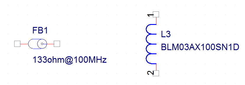

I am seeing some conflicting information online regarding Ferrite Beads.  I see some documentation that shows the schematic symbol for a Ferrite Bead as an Inductor with a reference designator of L and other documentation that shows the symbol as in the inserted image with the reference designator of FB.
What is the definitive symbol and ref des?

Here is a list of common ref des for the past 30 years -
They have the same electrical function:
"L" covers Inductors, Beads, Ferrite Beads,
Chokes, Common Mode Chokes and all parts related to the function of an electric
or electronic circuit that possesses inductance used in order to filter common
mode electromagnetic interference (EMI) currents without de-rating under high
currents and without causing signal degradation. Or, the geometry and
electromagnetic properties of coiled wire over the ferrite bead result in an
impedance for high-frequency signals, attenuating high frequency EMI/RFI
electronic noise.
I guess you can use FB for Ferrite Bead. Sounds good to me.

Post Options Post Options   Thanks (0) Thanks(0)   Quote tgrodnicki Quote  Post ReplyReply Direct Link To This Post Posted: 21 Dec 2017 at 12:28am
"Error 404: Page was Moved!"
In document from 2004 created by PCB Libraries and titled Standard Reference Designators "FB" stands for Ferrite Bead.
I followed standard from this publication.

The IEC 60617 graphic symbol for a Ferrite Bead is shown in IEEE 315A, Clause 6.2.11 as follows:
In addition the class letter to use in a ref des is E. See IEEE 315, Clause 22.4.
