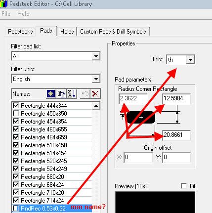

When I input dimensions into the Library Expert Pro they are in millimeters.
The naming conventions of the part and pad stacks are all in millimeters.
However, when I open the pad stack or individual pads, they are actually created in TH (or MILS).
This is incorrect, they should be created in MM.
FYI, this is all in Mentor Graphics Expedition Cell Editor / Pad Stack Editor

The part is created with mm values.
You must manually set the th to mm to see them.
This is a shortcoming of the DLL's used to interface to Expedition.
For some reason they don't allow me to change the visibility of the units.
They always show as the mil values of the millimeter dimensions until you manually set them to mm.
I simply don't have control over that units drop down at the current time due to the DLL's.
