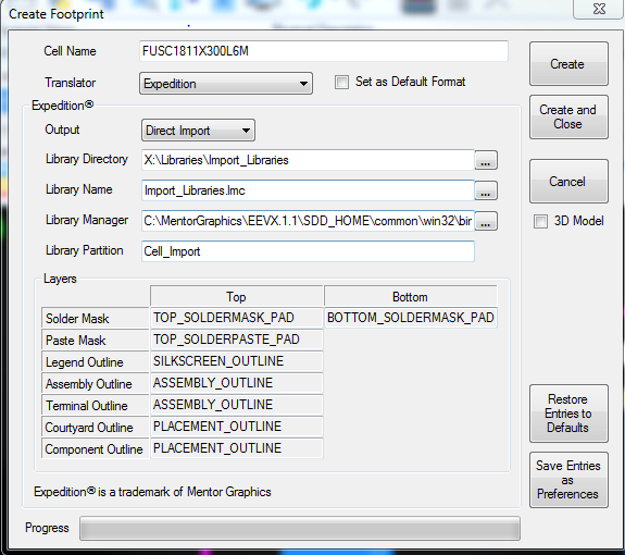

I am trying to export a component outline using direct export to Expedition as a placement outline. Settings
uploads/11838/Capture.PNG
Any thoughts as to why placement outline does not show up?
That error occurs when you have more than one person accessing the library at the same time. Expedition has multi-tasking locks for the library and the partition must be unlocked in order for the program itself to allow you to modify it via our tool. As an example:
Lets say 'Fred' has the library open and is viewing a part. The partition is then locked to him. Anybody else like yourself on another computer that tries to run the Direct Import to build the part will have an issue accessing the partition because it is locked. If you get this issue, make sure all instances of the program are closed, and if needbe check task manager for any hanging out in memory. Once the partition is released, you should be able to write to it via Direct Import.

I think you are missing the problem. The Solder mask, Paste Mask Legend Outline, Assembly Outline Terminal Outline and Courtyard all transfer. The Component Outline does not transfer.

Indeed it wasn't. Fixed. Not sure if it'll make it in .09 or be in the .10 pre-release.

Download and installed pre-release V2016.10. The component outline is still not transferring.

Post Options Post Options   Thanks (0) Thanks(0)   Quote jmeinert Quote  Post ReplyReply Direct Link To This Post Posted: 18 Aug 2016 at 4:44am
Still not working with 2016-10 pre-release dated 8/17/2016.

Post Options Post Options   Thanks (0) Thanks(0)   Quote jmeinert Quote  Post ReplyReply Direct Link To This Post Posted: 07 Sep 2016 at 6:26am
I believe that you have resolved this issue in the 2016.10 prerelease dated 8/22. Thanks!!!!  Big smile
