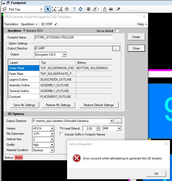

I have created a footprint with the Footprint Designer, When I export it to MG Xpedition the hkp file
is generated but I get an error message on the 3D model.
Is there a log file somewhere that might help in finding the problem?
Regards, Charles

Can you confirm you have full write permission to the location you're trying to save?
Maybe try a different location locally instead of the network?

Normally, the Footprint and 3D model folder is the same.
You're saving data to 2 different drives.
Try something different and let us know if it works.
