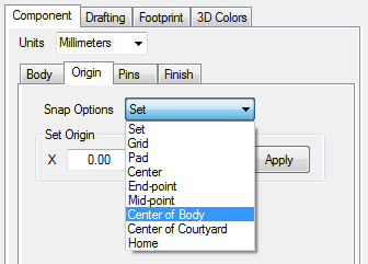

We added more FP Designer "Origin" tab options.
Center of Body and Center of Courtyard options are now available.
