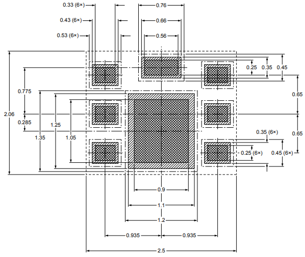

I need building one footprint DFN2020MD-6 (SOT1220)  (from PMPB20XPE datasheet).

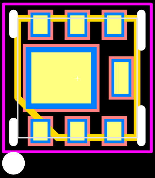

The Nexperia SOT1220 Case Code is a non-standard package.
The footprint needs to be created using the FP Designer and the manufacturer recommended pattern.
However, there are 39 Nexperia part numbers that use the SOT1220 Case Code available for free download on www.pcblibraries.com/POD
Here is what the footprint looks like:

Post Options Post Options   Thanks (0) Thanks(0)   Quote Tom H Quote  Post ReplyReply Direct Link To This Post Posted: 17 Apr 2025 at 7:52am
NEXPERIA_SOT1220 is the only name for this footprint.
