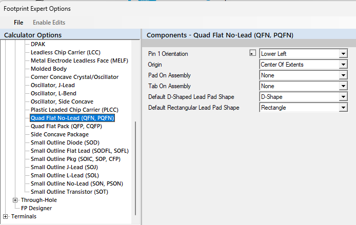

I am working on the Calculator Option File, and I would like to share with you one idea.
When we are configuring the default Pin1 orientation, Pad shape... In the Components-Surface Mount , Would be very crazy - no sense idea - to separate into two different options the QFN and PQFN. SON and PSON is another example.
The reason is the next, if we have a PQFN component with rectangular leads of course we will use a rectangular pad, but if we have a QFN footprint with a rectangular lead perhaps would be interesting to use a rounded rectangle pad.
Thanks for your comments.
Best regards,
david

Post Options Post Options   Thanks (0) Thanks(0)   Quote Tom H Quote  Post ReplyReply Direct Link To This Post Posted: 18 Jun 2025 at 9:01am
Is this a New Feature Request?
If so, you're in the wrong Forum Thread. Go here -
The component families are grouped together for easy code changes.

Post Options Post Options   Thanks (0) Thanks(0)   Quote dramos Quote  Post ReplyReply Direct Link To This Post Posted: 18 Jun 2025 at 2:59pm
It was not a Feature Request at the beginning of all...
But as I realized that the Option configuration could create confusion between the users, YES I will add it as Request improvement of the program.
Best regards,
