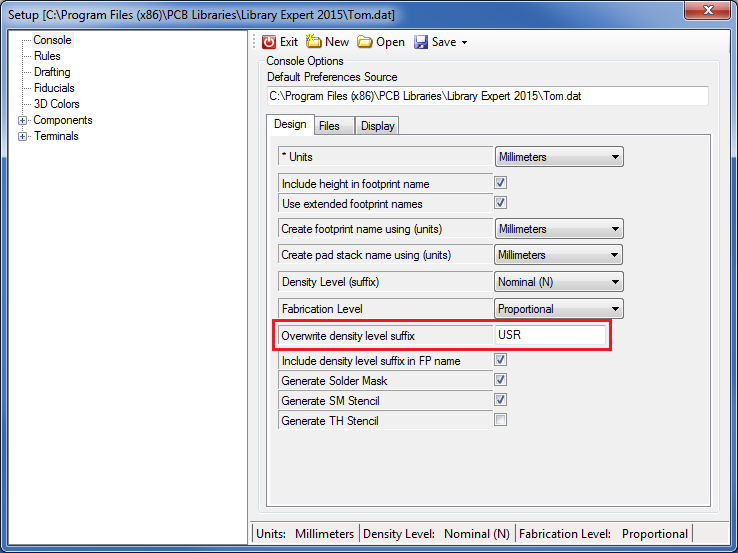

Post Options Post Options   Thanks (1) Thanks(1)   Quote Tom H Quote  Post ReplyReply Direct Link To This Post Posted: 15 Jun 2015 at 1:58pm
I would create a brand new Preference File.
We have updated and changed Preferences so much in the past year that it might be time for some users to create a brand new Preference file.
USER should only appear when you have USER text here: (remove all Text if you want to use Density Levels)

Post Options Post Options   Thanks (1) Thanks(1)   Quote GrungyRemnant Quote  Post ReplyReply Direct Link To This Post Posted: 16 Jun 2015 at 6:13am
Perfect.  I incorrectly assumed that would only be used if settings in the calculator were changed.

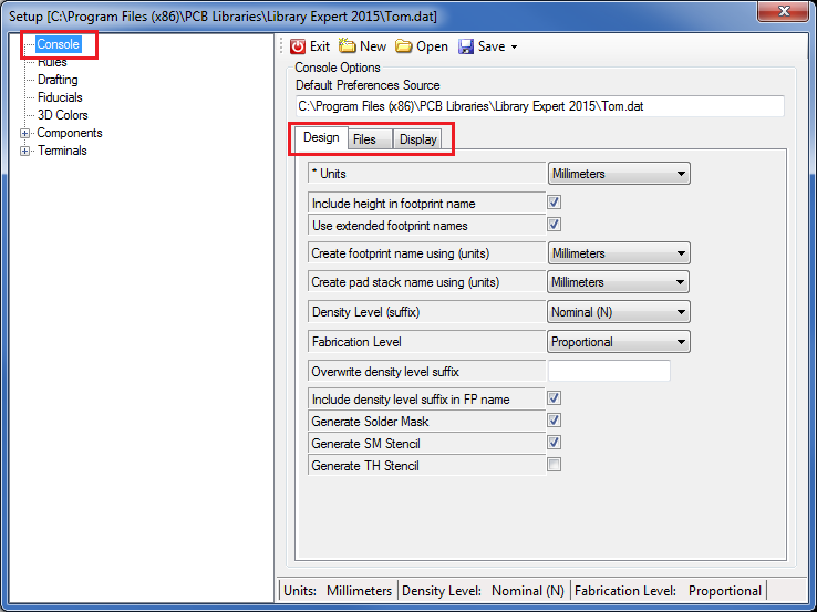

Post Options Post Options   Thanks (1) Thanks(1)   Quote Tom H Quote  Post ReplyReply Direct Link To This Post Posted: 23 Jun 2015 at 8:36am
Console Preferences store all the settings in the Console Tree (Design, Files and Display tabs) -
