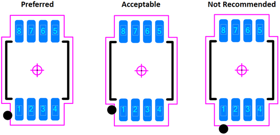

When using the calculator, PCB library doc strongly suggests that pin 1 indicator should be added by hand instead of the automatic way. I agree the automatic way is too dumb to be useful, it places the dot right in front of the pad where most likely a via will be placed and obliterate the dot. And also there is no way to move it.

The most important thing to remember about manually inserting polarity marking is to manually add them last.
However, you have a good point about putting the automatic silkscreen polarity marking to the left of pin 1 rather than at the end of pin 1.
We've heard this suggestion before.
As a result, by popular demand we're relocating the automatic Pin 1 marking to the left of Pin 1 for all footprints that have a Toe that is larger than the package width.
This will not affect any BTC (Bottom Terminal Components) like Grid Array's, DFNs, Pullback Lead PSON & PQFN, etc.
Thank you for your feedback.
This new feature will be in the next release of V2022.06 pre-release tomorrow or this weekend. We'll let you know.

Having the automatic polarity marker improved is a good thing. Hopefully some control will be given in the drafting tab of the part to offset the marker and to select among the 9 different shapes.

All silkscreen "clearance to pad" and "min/max dot size" are defined in Options.
At least we got this far after 6 years of customers asking for this.

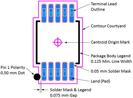

And here are the elements of a Land Pattern:
