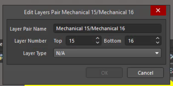

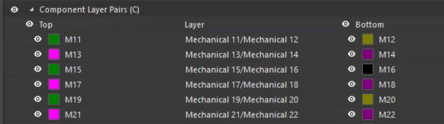

In Altium it looks like this:

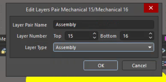

And in the edit:
How can i modify my code so it will just do the correct assignment:
