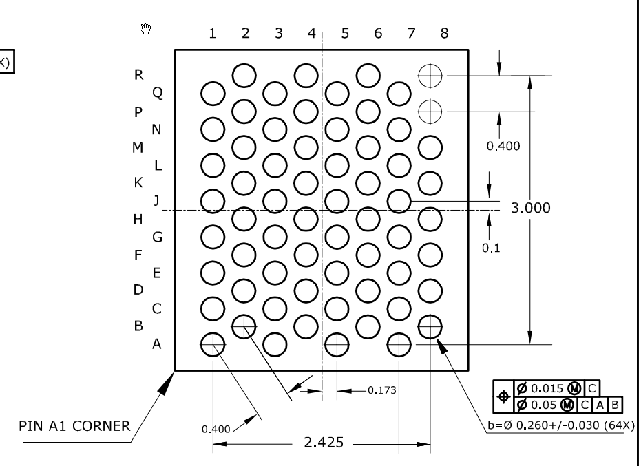

I am trying to use the LE Pro to create a footprint for a part using an WLCSP-64 package.
This has alternating columns of pins offset/staggered.
What do I need to create this footprint and STEP model with the LE Pro?
https://i.imgur.com/UwhkqDG.png

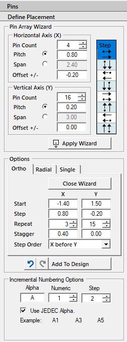

Here is the FP Designer Wizard settings for this Staggered Pin BGA.

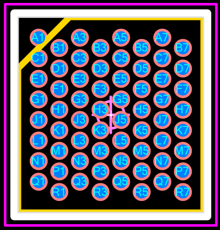

Here is the finished BGA footprint.
